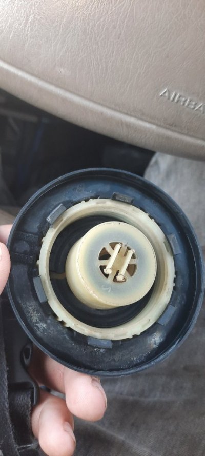

Well I kinda feel like an idiot I went out today to make sure the coolant system was fully burped and from what I could tell it was and when I got home I checked the coolant tank and it was still at proper coolant level and not boiling (I had been driving for about an hour in the city) so fully knowing it was under pressure I cracked the cap and it instantly started boiling and when I went to tighten the lid back up it wouldn't seal and stop boiling I started the truck to get the boiling to stop and to be able to remove the cap and when I looked at the cap the sealing ring was junk went to autozone and got a replacement cap and lone and behold it no longer was boiling when I shut the truck off. So I believe it was the junk cap that allowed the hot water to escape and overheat since the system had basically run low on water.
The attached images are of what the water in the system looks like now after flushing the rad and the engine block along with the junk cap.

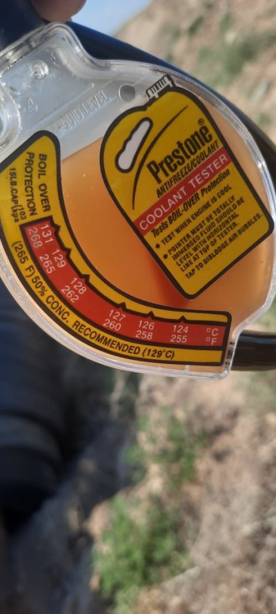

May I ask why the zerex is it because it is the only coolant that can be found with the matching for standard because I was running straight water after I replaced the rad cap and my Temps were fine at 190 but I went to my dad's place and flushed out the rest of the system blew out as much of the water as I could and added in my coolant (it was the prestone all vehicles mix because I'm cheap) and ever since I have been hitting 220 on Temps and I have confirmed multiple times that it was all burped out and the head gasket is not blown with no temp change could that be because it don't say that it meets fords spec or not?
