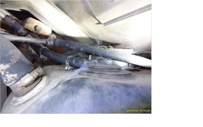

My 2nd gen '03 has the same type of vents that have cracked (both front and rear) and the front one actually leaks raw gas when the tank is more than 2/3 full while parked on a slope. I have removed the tank and found the manufacturer's name Eaton molded into them. After researching, I concluded they were made of HDPE, high density polyethylene, which is difficult to impossible to bond. I bought a low cost hot air plastic welder from Harbor Freight, and a few different shapes of HDPE welding rod from various online sources to practice with. After completely draining the tank and blowing compressor air into it for a few days until gas vapors were gone, I have now welded the cracks. I believe the welds were successful, but I have not yet pressure tested to verify. This is a casual project, so I won't know for a while until I finish the job. but I thought I'd post it for consideration of an alternative process. I'm taking photos as I go, and if eventually successful I will post results. Be careful the welds don't interfere with the quick connect vent line fittings. Just be extra careful that there are no fumes present. Even though I felt it was safe I had a fan blowing the area and a fire extinguisher handy.

I am curios as to how you became aware of the leak? Smell of fumes? A failure code? I have a 2001 and smell fuel when I exit the vehicle. A new gas cap seemed to help, but it is back.

The "service engine soon" light came on and the code reader returned "P0442."

Can't tell from pic exactly where the leak(s) are located. If it's the hard plastic that's cracked, how about cleaning and applying some epoxy to seal it from the outside? Just a thought but then again the ethanol/fumes may not be friendly to the repair. Is there an epoxy mix that can hold-up to the gas and fumes?
I did find https://www.jbweld.com/projects/gas-tank-repair but it seems tailored to holes as opposed to hair line cracks. :banghead:
