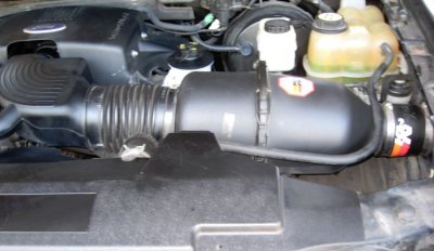

Finally did this mod and it was def worth the 13 dollars it cost me.... I get about 2 mpg more and def better throttle response.... 2 thumbs up from me.... Dont know ne other mod u can get the performance from for 13 dollars....... :)

yeah smooth thats the mod. i should take a pic of mine. with the truck horns i have too. i like mine. i mainly like the quicker throttle response and the little extra power i have. now to fill up with chevron gas and ill know if it worked for better mpg.

Come on nvycrmn..... Everyones doing it.... Lol its def worth the 13 dollars and easily reversible if u dont like it.... Dont think that will be the case...... Just take ur time and make sure to shape the pvc with a file or dremel.... That was the most time consuming part for me.....

dont buy the pvc ill give you my left overs. that way all you need the coupling. ill show you friday what it looks like. super easy to do. took about an hour.

I drove about 3 miles today and I can positively say I felt a quicker throttle response. I did not lay into it, but its noticeable.

Just a quick update, I have noticed a drastic improvement of throttle response and pick up. Ive had more "seat time" as of today and I am extremely pleased with the Motts

i have increased my mpg. about 1. not bad for $15. i like how so many people are doing it now. such an easy mod with so little money and time. but a belt sander helps some times too.

after grinding the pvc down to fit and all that jazz, i noticed that when it was on the stock airbox, the pvc was actually thicker than the snout, so I said to hell with it and pulled hte PVC out of the coupler, cut a v into the coupler so that it would fit into the fender without having a hump to mess up air flow and called it good.i did mine for 6.50!
