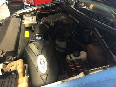

Absolutely beautiful but I am a little bias.
What's next for this beauty?
Motor!! my problem so far has been that the cylinder head guy and now the engine builder are not as fast as the body shop and everyone else lol
Engine builder has all the parts needed now so hopefully that comes together by the end of February, I have some odds and ends I need to get so I can do them before/at the same time the motor goes in, basically the upgraded fuel pump and fuel system bits, new motor mounts, true trac diff, gauges, gonna do all new o2 sensors, water pump, PS pump. All the stuff that's good to tackle "while you're there" doing the motor swap.

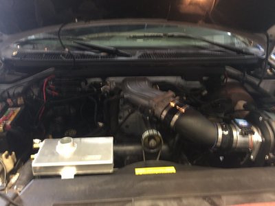

Builder sent me this picture and says it'll be all buttoned up by the end of the day!
Full specs on the motor:
Iron 5.4 block bored .020" over
ARP Main studs, side bolts
Ford Racing Cobra Jet Crank
Manley H-beam rods with ARP2000 rod bolts
CP forged pistons with coated skirts
Romeo 8-thread ported PI heads
1mm oversize intake and exhaust valves
CNC ported by Performance CNC (cncport.com)
Crower springs and heavy duty retainers
Custom Bullet cams spec'd by Todd Warren
Moroso oil pan
Ford Racing oil pump (13-14GT500 spec) with Boundary billet steel oil pump gears
Ford OEM timing chains, guides, tensioners

Not much you can do to make a 90º V engine with overhead cams narrower.
