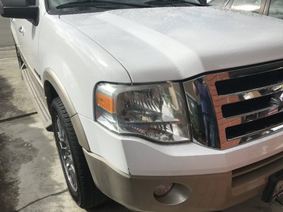

This is a confusing and seemingly expensive subject. The headlights in my 07 Expedition leave me wanting more. The current output is not great and they are faded and crazed (is that the right word?). I did a restore on them and they are better than before but the light is pretty sucky:IMG_0105.JPG IMG_0107.JPG

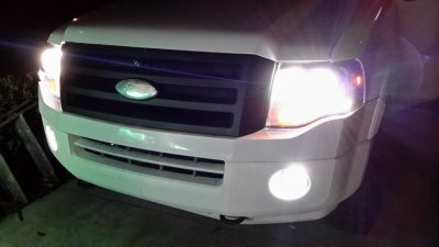

I put 35W HID low beams in my old 05 and they had the best light of any headlights that I've had. They were way better than the projectors that I have in the 17 right now.
