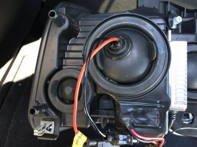

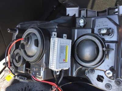

I should have taken pictures while I had them out. It was cold here yesterday and I was trying to get them done before I lost the sun which was giving a little warmth. I recommend going with the xenonhids.com and getting their galaxy 55W ballast for whatever bulb that you need for your F150. The installation was fairly easy. I had to cut a 1" diameter hole in the rubber cap to accept the rubber grommet that comes with the harness. I found a great spot on the back of the headlight housing on the side of where the projector bump out sticks out next to the access to the high beam bulb. I had to cut a small opening in the case to pass some of the other connectors and wires through. I sealed that opening with several layers of high quality electrical tape that I layered like shingles so that any water that gets kicked up sheds off.
It took less time to do all of that than it took to type. If I have reason to remove the assemblies, I will take pictures.
Updated 3/16/17
These are pictures of my installation. I've decided to replace the low beam dust covers and route the wires out through the same opening as the red and black wires that are coming out in the area with the black tape.
