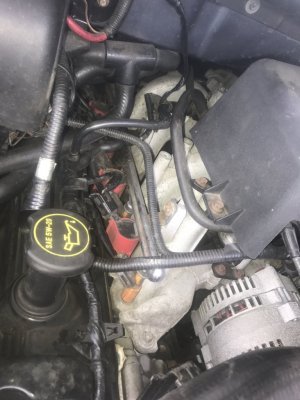

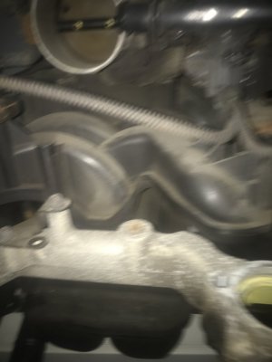

  • I had the picture of the o1 intake because I still have the complete top end in my basement from the donor engine. 01 F-150
  • The picture of the 99 is on my running trucks. 99 Expy EB 5.4L w/ rear Heating & Cooling.
