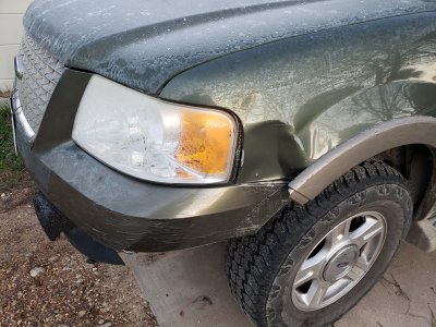

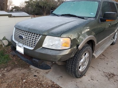

Well, after a long delay due to business travel and just being too busy, a couple of things to share...
Drove up to Kelso to have the bumper worked on again. Doctored up the ends where it ties into the trim. The guy did a really good job and I'm thrilled with how it turned out. I also had him weld the A-frame back on. Tried the bumper in all white but didn't like it so it's now back to two toned. Just need to add a little more beige to tie the two together.
Here's the before...
And here's the after...
