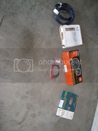

    The components:
    JBL P660C
    Infinity Kappa 682.9cf
    16 AWG Kicker Speaker Wire
    NVX Sound deadening
    JL Audio Stealthbox
    Kenwood DNX5190
    Power Acoustik PT-120CM 12" screen
    Alpine PDXV9 5 Channel (birth certificate of 133 rmsx4 and 530rmsx1)
    Memphis Audio amp kit/rcas

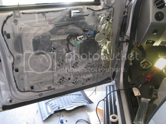

    Front Speakers mid install - added more sound material before I was done (forgot to take pictures of the back)

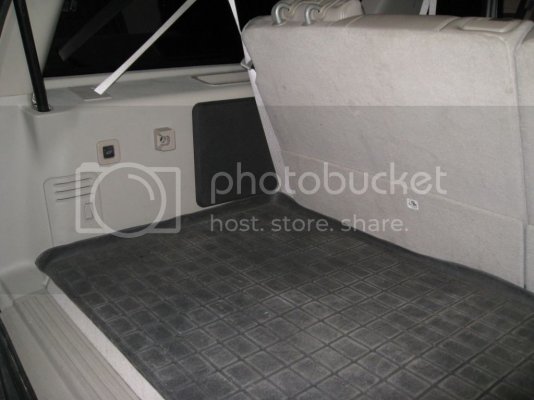

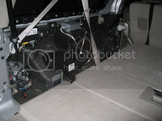

    Factory Sub

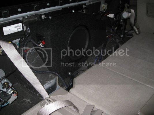

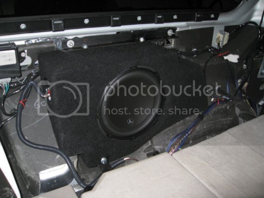

    The JL

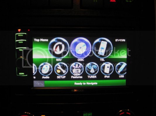

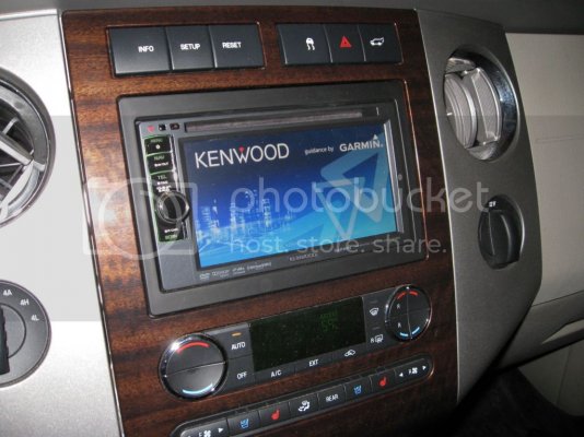

    Head Unit (with lockout bypass for DVD/NAV installed)

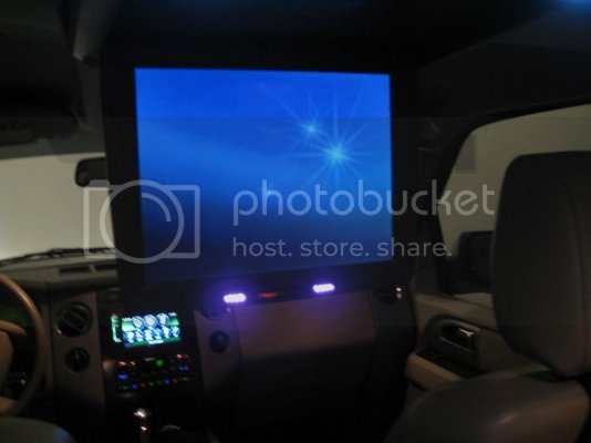

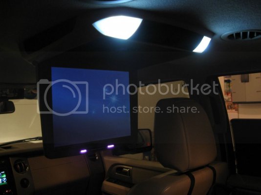

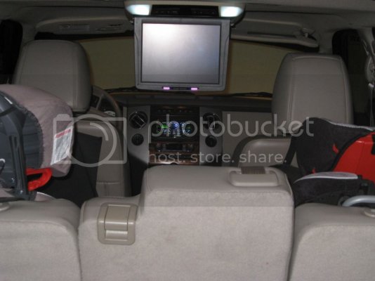

    Overhead Screen (12") - You couldn't go any bigger or it would get in the way of the overhead vents....It has LEDs - now it makes the other lights look dirty :p

    500 is a lot and what you have is a box...in a box...in a box...sub enclosure inside the panel...and the cabin being the final enclosure/box...more space for the air to travel...i think when its said and done...my final setup will have a 5th rim mounted on that side and everything redone...our install is very similar...you have your sub in the panel and i have my amp...my 4-ch is in the same spot as yours

    I 'was' going to do a fiberglass build myself....but then I used logic.....
    JL 10W3 - around $260 from discount stores
    Fiberglass/wood materials ~$100- $150 (lots of odd curves under there)
    Mounting Bracket, carpet, etc ~$20
    I paid $600 shipped for this complete unit......I probably paid about $100-$150 more than doing it myself.....but I saved the 10 hours it would have taken me with all the curves and layers.....well worth the extra money to save my time - I did the rest of the install in less than 10 hours....

    Sub grill came with the JL kit; its MDF wrapped in fabric with built in nuts that get screwed/bolted to the side panel. I put some sound deadening between the grill and panel to ensure no rattle.
    As far as your idea of using the 10" in the factory enclosure I believe you are flawed. The polk is over 5" deep and you need spacing behind it. The factory 8 is something on the order of 2.5" deep. You would have to radically modify the factory enclosure to do three things (1) build out more depth (2) double the volume of the factory enclosure and (3) create a new mounting surface with enough space for excursion....this is all assuming the factory ABS plastic enclosure will withstand more SPL...Im not so sure it will without cracking. You are easily going to spend a couple hundred modifying that stock enclosure with fiberglass and mdf...
    Keep in mind you can get the JL audio one for $600....that includes a
    JL 10W3 - around $260 from discount stores; Fiberglass/wood materials ~$100- $150 (lots of odd curves under there); and then Mounting Bracket, carpet, etc ~$20...so it really only "costs" about 100 in labor ......and no mess up/guess work. I have done fiberglass before....it isn't hard as long as you know what you are doing but takes a very long time....Just something to consider...
