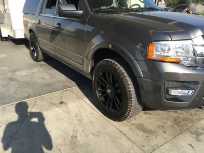

is it possible to downsize from the 22"inch wheels to 18's or 20's without effecting performance or OEM suspension?
I would prefer a smaller wheel and beefier tire combo.

It's possible if their aren't clearance issues with the rotors/calipers. Each tire has a total weight capacity that it can safely hold. Check the side of your 22's and you'll see the weight. When going to a smaller diameter wheel/ tire combo, most go the other direction. You'll need to see the charts that show what size 20 or 18 inch tire you'll need to keep weight the same or a little higher to be safe. Most of this info should be online, or you can visit your local tire shop, they have that info. I used to be in tire business years back, most customers wanted a lower wider tire known as plus sizing. The other thing your after is to keep overall diameter the same. Any change from factory affects gearing, speedometer reading, fuel mileage. Hope that helps.

So I understand correctly. I must maintain the overall dimensions of the original 22 wheels and tires and the truck will have no issues with speedometer, mpg and gearing?
Correct?

It should, in theory, any time you change anything from what the manufacturer designed it with, theirs always something different in the way the part works. For example a narrower taller tire will give a cushiar ride over bumps. The trade off will be it won't be as stable as the lower profile tires around corners. Theirs always pluses and minuses in any upgrade or parts change.

I didn't ask or can see from your post, is your SUV 2 or 4 wheel drive? Mine is a 2000 that has 285/50 r 20 tires on it. It appears to have a slight lift on it from previous owner. My speedo is just about spot on when I pass one of those speed digital police signs on roadway. Again don't know what your wheel offset is, or if newer models have same fender/ quarter panel clearances.
