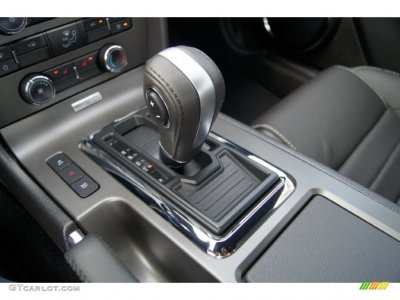

Unfortunately, the 2017 Expy doesn't have those. It does have "+/-" buttons on the shifter but they don't seem to operate the same way as the paddle shifters on the Explorer. What's the best way to deal with the engine lugging while going uphill? It seems the transmission needs to be a bit more sensitive when it comes to downshift points. Am I going to have to just live with this or should I talk to the dealer about reprogramming?
Part of it is turbo lag and part of it is the trans tuning. The shifter works the same as your Explorer did. Before making your ascent just hit the - button and the gear indicator will pop up next to the gas gauge (assuming you have the fancy cluster) showing all 6 gears. Just down shift it to the gear you think you'll need and it will hold that gear or lower. If you want a higher gear hit the + button and you'll add a higher gear to the mix. I think its a great system as you can manually select your top gear and it will still be fully automatic in all lower gears. Its a great feature in the mountains. Or drop the shifter to M and shift it manually.
