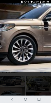

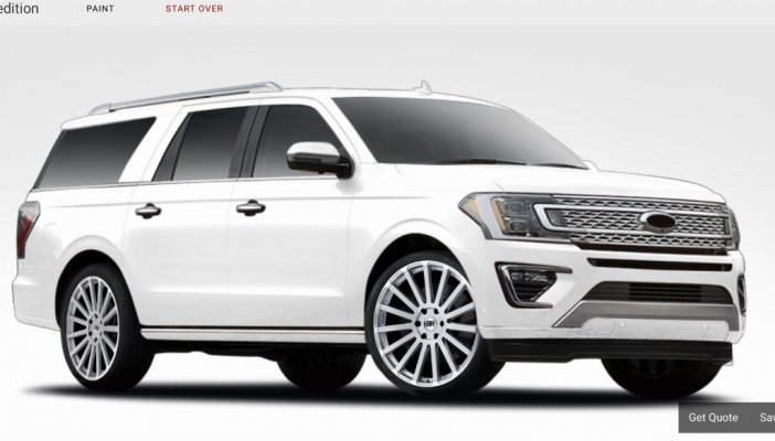

I think the ‘18 Navi select and reserve wheels are incredible!! When I get a minute I will post some of the wheels I am considering. Here is one I really like but am intrigued by more spokes (turbine) like the Navi.
edizzle
Dec 25, 2017
974
469
Cashiers
They are matte silver with a diamond cut/polished lip. Hard to tell in the picture. What do you think?
dlcorbett
Mar 26, 2014
2,557
899
tx
They both look good, i do prefer tbe first ones more though
