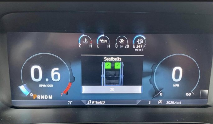

Sorry to reignite a thread. Was there a forscan option to disable the graphic on the display? I am struggling to find it and would love to make that graphic go away. Maybe my search skills are just that bad…

No way to disable the graphic. It auto dismisses after belts are buckled and you start moving above 5mph or 60 seconds. Whichever is first.

My 2022 does not operate in a 'whichever is first' mode - that graphic stays up for 60 seconds every time unless I hit the OK button.

I'll re-check mine later, the way the manual is worded isn't exactly clear. it also mixes the lamp and warning display graphic.
