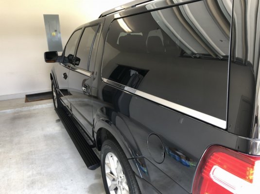

Window trim looks great! I may try it on mine, how long did it take to put it on?
ExpeditionAndy
ExpeditionAndy
Aug 31, 2013
3,711
1,126
Fort Wayne, Indiana
JRC, it took about 30 minutes per side, but I was taking my time. I cleaned the glass then wiped it down with denatured alcohol and dried buffed it a little with clean cloth. Then I taped it to where I thought it should go and moved it around a little until I thought I had it perfect, then I flipped it up took off the backing on the tape and checked it to make sure that it was still where I wanted it then I stuck it to the glass. I Had the window open so I squeezed from both sides as far as I could get and rubbed the hell out of it to make sure it was making good contact. I don'w want them to come off in the automatic carwash. :) Today I gave them a nice coat of wax to keep the acid rain off of them. :D
