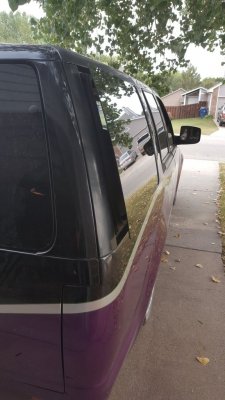

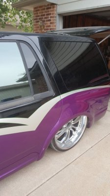

Hopefully im the first dummy to try this. But i absolutely hate those bolt holes. So i did something about it. Hope you all like

Took the glass from non-power window truck and bonded the hinges and actuators to the glass?
Yes sir. If the 2nd gens can do it. Why not the 1st gen.. you have to use non power qtr glass and remove the way it mounts. Which was a huge pain in the ass.. then bonded it all
