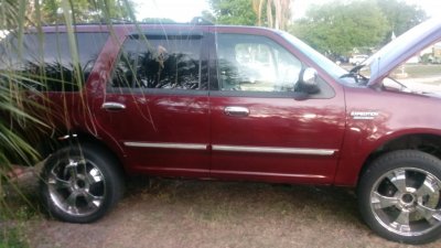

Hey guys about a month ago i picked up a 98 4x4 expy and a 99 EB expy for a price of 1400, the EB was supposed to have a blown motor. Since then i have tuned up the 4x4 and inspected the EB, it was missing 3 coils once replaced it runs great. Now i am for sure keeping the 4X4 and unsure about the EB, now the 4x4 has a lot of rust underneath and i noticed the engine block itself has a buildup of rust. Where would you guys recommend picking up a crate engine, i would prefer to get the dohc from a navigator if i don't have to change harness and everything else.

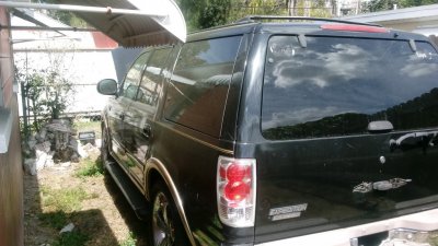

Ok so here is where I am now. Just found out from the dealer i bought the trucks from that he cant get the title for the black one because the Honda dealership that took it as a trade and sold it to him, too many miles for them to sale on their lot, took in the wrong expy title from the original owner. Apparently she had a green one and a black one and whoever did the paperwork didn't verify they had the correct title so the black one will be parted. I really hate to do ot to a prefectly good running truck but oh well. So i will be swapping some of the EB features to the 4x4. Build to start soon.

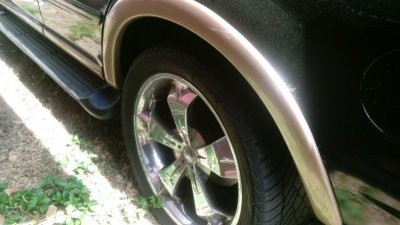

Replaced the transfer case motor today, seems to have fixed the 4wd problem, but the previous owner disconnected the front drive shaft so There could be other issues. However i will have to wait until next weekend to reinstall that and test. Took the 22s off the parts truck.

oh, and for the love of god, take off those damn rims ASAP
