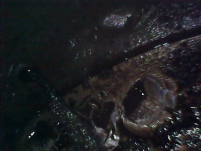

I bought a 99 Expedition with problems...
There is a hole in NO 3 piston so I need to pull the engine DOOH!
This will be the first Gen 1 pull for me so I would like the procedures please...
