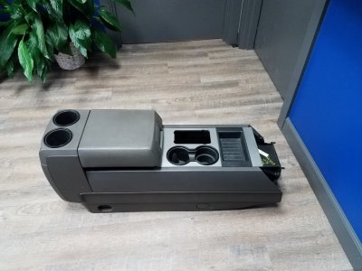

    Currently working on getting a junkyard EB console into mine (just yanked the shifter out of it, left a hole I plan to fit with a plug or a storage bin), will update once I figure out how it installs

    I too just bought a 08 that was once Homeland Security fleet. I picked up a console from a salvage yard ($100)and started looking to install it today. Seems there is some mount that the console bolts to that I do not have. I'll call the place next week to see if I can get that. I'd love a picture just to see where the harness is, they cut it getting it out then gave me the connectors. Really want the console controls to work but I don't even know if the vehicle side of the harness is even there. I'll be picking up the third row and seat belts within the next few weeks.

    I'm in the process of converting my 2008 SSV, as well. All holes for console and 3rd row seat belts are present, but had to tap threads. Trading out rubber floor for carpet. Will post pics when complete. Love to see others' stories and pics. Curious if you found the wiring harness to connect the front center console...I can't seem to find the part number in the repair manuals...

    yes, want to hook up the rear a.c./power on the console.... Will want to remove shifter as it is wasted space.
    $1000 for all King Ranch seats including third row, carpet, steering wheel, and center console. $350 in addition for prem stereo and mirrors (to replace mirrors with police spotlight holes in them!) With the 3rd row going from $400-$700, I felt this was an amazing deal.
