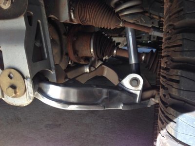

When the 03' came out it had aluminum control arms.
Later they switch to stamped steel...
Why?
To save money?
Seems like the Aluminum might be better, and cost more to make...
ANYONE? ...opinions?
I might polish my rear arms. LOL seriously...
Just cause I could.

They are much more expensive to produce. The reduced weight and higher torsional rigidity makes them perform much better, why do you think that the Raptor has great big aluminum a-arms?

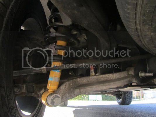

I checked out pictures of the raptors arms. Aluminum like you say.
They look like expedition arms, sort of...
Are other f150 arms stamped steel?

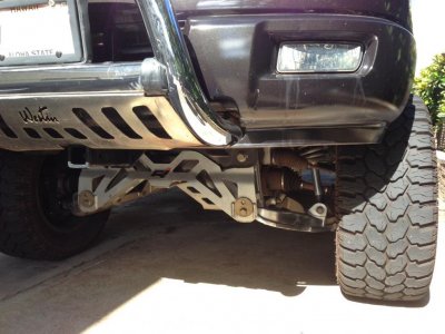

Like your expy as well, the front bumper change and lift sure make it look nice.
I had a 97' and always hated the stock pointy bumper...
