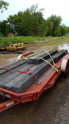

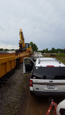

mine is a 16, 373 rear gears and hd towing package. the trailer weighs 1800 empty, cross ties 250 each 16 of them on deck so around 6400-6500 lbs, trailer is rated at 10,200 so i was far from full.
never knew it was back there.
your pulling a large bulb through the air, you will know its there.
i wouldn't have any issue pulling a 25 foot alum trailer. tons of tq and you can lock out higher gears.
i am sure the 18 with the ten speed and higher hp and tq gen 2 ecoboost, you will not have any issue, get the towing package and be set.
i am sure the ten speed in tow haul will allow select shift to lock out higher gears if you need to
the guy in front of me had a tandem axle trailer rated at 7500lbs...he overloaded and his tires played lets ride the edge from bending the axle...he had iirc 28
