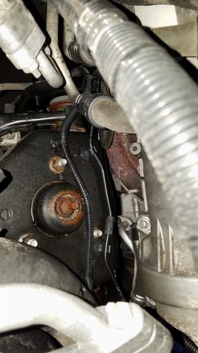

Here's the video I'm going by. Only thing different I plan to do, is unfasten the coil mount and shocks through the engine compartment instead of through the wheel well.

The top strut mounts should be accessed with a hand ratchet from the wheel well.
It's a big truck, it's not like a bimmer where the strut tower is right up under the hood.
Also, strut tower torque specs are LOW, barely over finger tight, definitely NOT power tool/breaker bar tight
