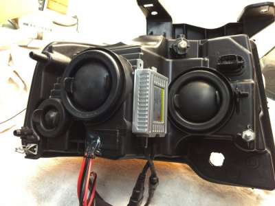

Looking at the website for XenonHID.com, there is a drop down box for power relay harness/anti flicker and capacitors. Would I need those as well??
You shouldn't need the anti-flicker if you get the Galaxy ballast because it's built in. I didn't use the Relay Harness kit because I felt the wiring would be adequate for HIDs. They say that the HIDs draw more current when they fire off but it is momentary and ballast draws very little current once the lights are on.
I should add that the Expedition doesn't use a Canbus system so even if you don't use the galaxy ballast you should not need the warning cancellers and capacitors.

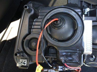

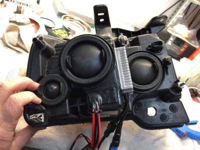

It only took me about 30 minutes per side. If I had to do over again I would see if I could avoid cutting the rubber dust cover and run the wires and plugs through the rectangular hole that I cut. I think it would be cleaner that way. I might still do it but I would have to buy new dust covers.

I will keep that in mind when I do my new lamps. I cant visualize what you are referring to, but when I get into it, I am sure I will. If there is enough space in the dust cover to route the wire harness, I will attempt that. For me, dust is a major electrical and mechanical killer in my part of the West, so cutting additional holes in the dust cover is not a good option.
