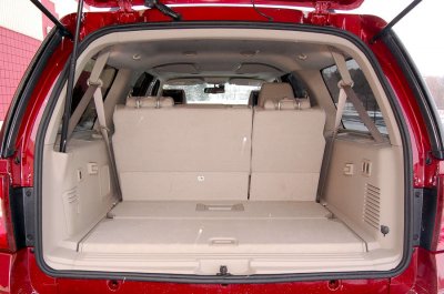

Hello all. New guy here, hoping to learn from those wiser and more experienced than I.
My wife and I really want to purchase an Expedition, and we've found one locally that suits all of our needs (lower miles, heavy duty towing package, good condition). There's only one glitch: It doesn't have a third row seat. It looks like it came from the factory equipped with cargo compartments rather than a seat. We have two kiddos now and hope to have more, so in order for this Expy to work we're going to need a third row seat.
Is it possible to install one? I see Expy's in salvage yards, so I think with some hunting I could find a seat. But I'm not certain what other equipment would be needed or if this is even possible. We don't need the seat immediately, since it will be a little while before kiddo #3 comes, but I can't buy the Expy we're eying unless I know we can get a third row in there eventually.
The Expy we're looking at is a 2008 XLT.
Thanks in advance for your help.

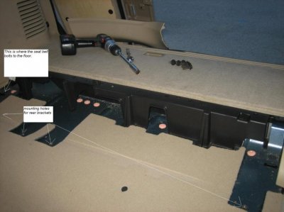

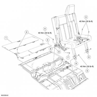

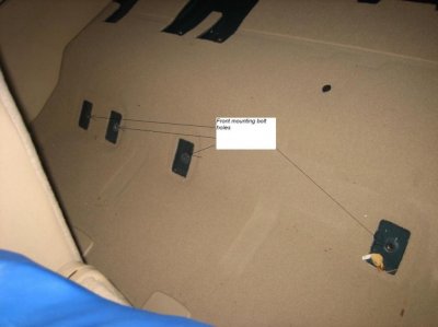

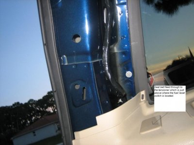

Adding 3rd row belts and refitting ALL seats into it is a one-evening project
ALL the holes are there. They're untapped, which scares away people, but truth is Ford screws are SELF-TAPPING
It all bolts right in, you just need a seatbelt donor and two rear pillar trim panels OR a good eye and a reamer

This is good news as I am looking at one of these trucks right now. So, if the holes are there, are there rubber plugs covering them? I saw pics someone posted of a shorty SSV where it appeared there were already bolts installed in the holes for the 3rd row seats (just no seats).
Let's put it this way:
This is an 09 SSV that had 3 mismatched seats TOTAL when purchased
No i didnt drill nothing. Some holes had plugs some had bolts. All holes were already there ready to be used.
PS if you need them to fold, preferably buy manual seats, else youll need all rear side plastics and a harness from donor vehicle or will have to do some improvising for powerfold functionality
