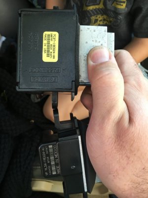

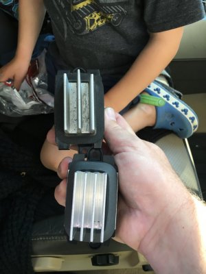

f150dave2002
Sep 27, 2011
44
Aptos, California
I thought I took picture of where it came out from but I can only find old vs. new resistor for the front blower control.
