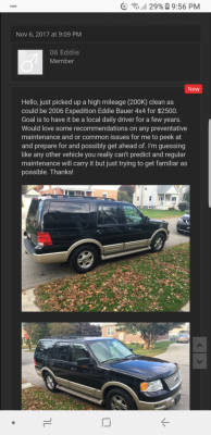

Seems like people including myself are just airing out the problems with the hope of an assist. Real people with real cars equals real problems so emotions such as hello requests are not required. Either assist or skip over the topic. The most minute response could help a stranded motorist while the forum rules guy serves zero purpose.
Ok wise guy your point doesn't stand, BECAUSE on your first post you had the common courtesy to say hello & thanks before diving into your problems, but now you're Mr. Macho-Man defending a person who doesn't give a f**k and just expect answers to a rather useless thread.... bottom line is, you ask nicely & we'll answer nicely, ask bluntly and you'll get a blunt answer.
