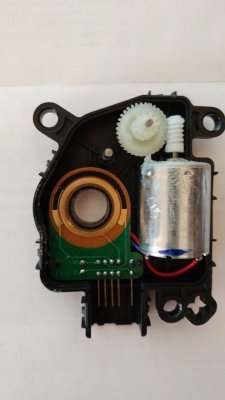

I have the same issue and replacing the blend door actuator solved it temporarily. I opened up my old actuator and none of the gears are stripped. I am thinking about unplugging the actuator to see if the noise stops (luckily the blend door is stuck in the face position and not the defrost or the floor)

The gears don't strip out inside the actuator, the big exposed drive spline either loses a tooth or the housing cracks allowing the gears to slip past one another. Never seen one where the gears inside stripped out.
