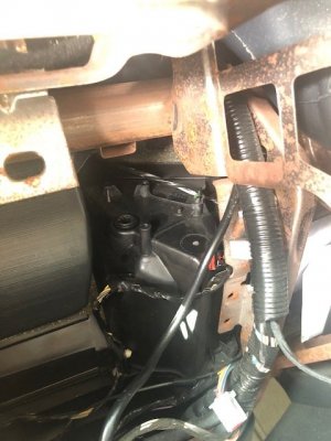

I opened up the actuator and all of the gears look good. After watching a video on YouTube I removed the gears and it looks like the tracks that are used to report back the position are worn out. My old actuator didn't have the tracks but the Dorman one I replaced it with a few years ago does. If the tracks wore out after a year then it's a terrible design.actuator.jpg

I opened up the actuator and all of the gears look good. After watching a video on YouTube I removed the gears and it looks like the tracks that are used to report back the position are worn out. My old actuator didn't have the tracks but the Dorman one I replaced it with a few years ago does. If the tracks wore out after a year then it's a terrible design.View attachment 20923
Worn out or just dirty?

Straight up gone - the electrical track wore away. There is a video about this bad design on YouTube. I contacted Dorman and Rock Auto (place of purchase) and I am sending it back for a replacement (lifetime warranty).
I'm glad to hear they are honoring the warranty but what a PIA to have to change it again.
