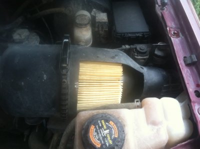

I have k&n...u won't see hp gains but slight increase in mpg... since u have 02... search gotts mod in the site... there's a write up to make ur own intake for increase mpg for about $30 or less

I also installed a K&N cold air intake kit. As has been mentioned in other posts, the problem with these is that they're designed such that they actually "breath" in the hot air from the engine bay. Intake air temps reached 154F on mine once when I was idling through Orlando with an ambient temperature of 96F. Personally, I think you'll see similar gains by buying a Spectre or K&N replacement air filter and installing the gotts mod on the stock intake assembly.
