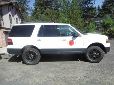

I did the Ready lift recently (Fat Bob, $240). I also increased the tires to 275/70/18 (F150 rims) and went with Hercules 10 ply rated AT tires. I love the ride, especially the off road performance. Very much better. Gas mileage about the same (18.1 mpg on recent 1000 mile trip with 300 miles off-road). Ride feels slightly different, but nothing the family has noticed. It is nice sitting up higher too. I have 2 1/2' clearance in the wheel wells all the way around, despite the optics of the photo. I did an alignment after the lift install. Despite the claims that this was a 3/2 lift, it is more like a 2/2 lift. The actual spacers are 1 1/2" all the way around, so that is what you get all the way around.
