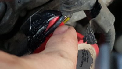

I ran two fans on my 03 and used a wire harness from a set of foglights i had laying around cause it had a relay and fuse already wired in. I got the trigger from the a/c wire I had used a power probe (test light) sorry dont remember the color of the wire, but u can grab it from the wireloom that runs on the passenger side of the timing chain cover.

I tried a black wire and a grey with white? Can't remember but both had power, even with the a/c off. This project should be done by end of March so far I have all the stuff needed for the task. I'm just trying to get more info on the wiring. I found every thing except a positive or negative A/C signal.

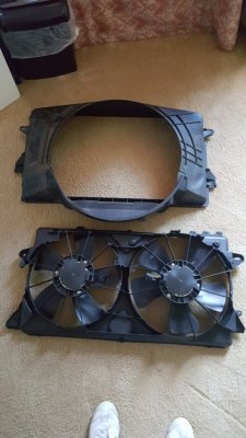

What I have:
Flex-a-Lite 31165 controller
Electric fans off a 2010 expedition
10 Guage wire
I had to fab the fans a bit but in the picture shows what they look like fresh from the box compared to the fan shroud.

How did this conversion work out? I'm interested in doing the same but with a 2000 Expy. Currently have 2, 16 in. fans pulling 1500 cfm each but they don't seem to be able to keep it as cool as I want it to be when the outside temp goes 85+. Judging from your picture, it would fit without too much hassle. Was there a huge difference in CHT before to after the conversion?
