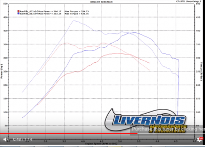

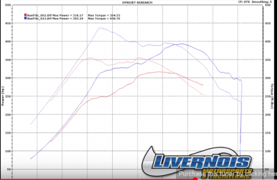

I got curious. The following graph is directly from the 5Star website http://5startuning.com/got-2017-f150-3-5l-v6-ecoboost/and shows a 2017 3.5L EB F-150 dyno "@ Wheel SAE J1349" (I admit, I have no idea what that is; I'm assuming its a standard test procedure for power testing "at the wheels"). stk-87-vs-93-perf-V3.jpg
A quick review of of chart shows an unmodified 3.5L EB pushes in the neighborhood of 325-330hp (peak power) at the wheel.

The 2017 has the advantage of improved output (375hp and 470 ft-lbs) and the 10-speed. Not to mention it doesn’t state whether it’s a 4WD or not. I’m guessing not with that output.
This is a 2014 with 4WD and the EB. It’s also most directly comparable to the 15-17 EB. It’s a 31% powertrain loss, which isn’t abnormal.
A 375-hp engine losing less than 20% drivetrain (like the 2017 chart) is pretty remarkable. That 10-speed must be amazingly efficient, and/or the 375 is a bit of a lie.
