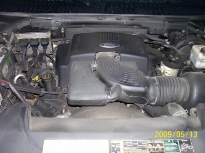

Well, I found out what it was.
Apparently, one of the relays, more specifically the PCM relay, had burnt/melted plastic around one of the center prongs.
We went out, bought another one, put it in, and it started right up.
I'm hoping that this is just a one time deal, though I'm always worried when anything electrical burns.
I didn't notice any water around the fuse area, but I'll keep an eye out for it.
Thanks for any help. Now to tackle the rear end.
