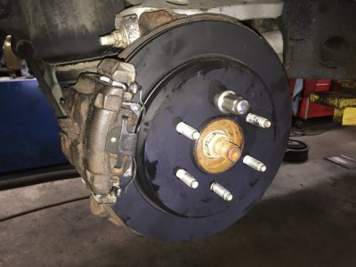

The huge nut under the hubcap in the middle on the rear wheel, on what looks to be the axle... does it need to come off to remove the wheel?
What about to change rear shocks?

Adieu can you post a picture so we are absolutely clear about what you are asking so we don't give you the wrong answer?

The thing in the verry center on the rears. On the axle itself. Visible from outside if hubcaps are off

Does it look like the nut this picture? If not you only have to remove that nut to pull the axle half shaft. The picture is from my 05 when I had the rotors and pads changed.

IIRC its 36mm. And no, you do not need to remove it to remove the wheel.
If you have removed all the lug nuts and the wheel is still stuck to the hub, you most likely have corrosion freeze. Squirt around the hub/wheel mating surface and inside the lugnut holes around the studs with some weasel piss (any penetrating lubricant of your choice). Give it an hour, squirt again then use a block of wood against the wheel and give it a few sharp whacks with a heavy instrument of your choice.
I do NOT recommend using a chisel to drive in between the hub and wheel. There are slots on the back of the wheel for that purpose but it never works out the way you want it to.
And no, you do not need to remove the axle nut and axle stub from the hub to change shocks.
