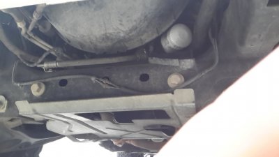

Being that is my first 3rd Gen and my 4th expy. I notice that I don't have a skid plate / splash shied behind the front bumper to protect the front of the engine. Since you can clearly see the belt and all the pullys. Is there one or am I just missing it. Since I can't seem to locate it in the parts listings. Any help?

Can you maybe make a First or second gen one work? Are there any threaded holes to bolt up to. If not, then your looking to drill and tap, or use thread nuts to bolt a pan up to. If you have to make your own, you'll need a sheet metal bender to do proper, but you can probably fake it with some time, and ingenuity. It won't look as pretty as the factory Ford one on mine, but who cares, nobody besides you, or a tech will see it.

I was thinking that, but by the looks of it the 2nd gen seems short. I wish I did have a bend n brake
