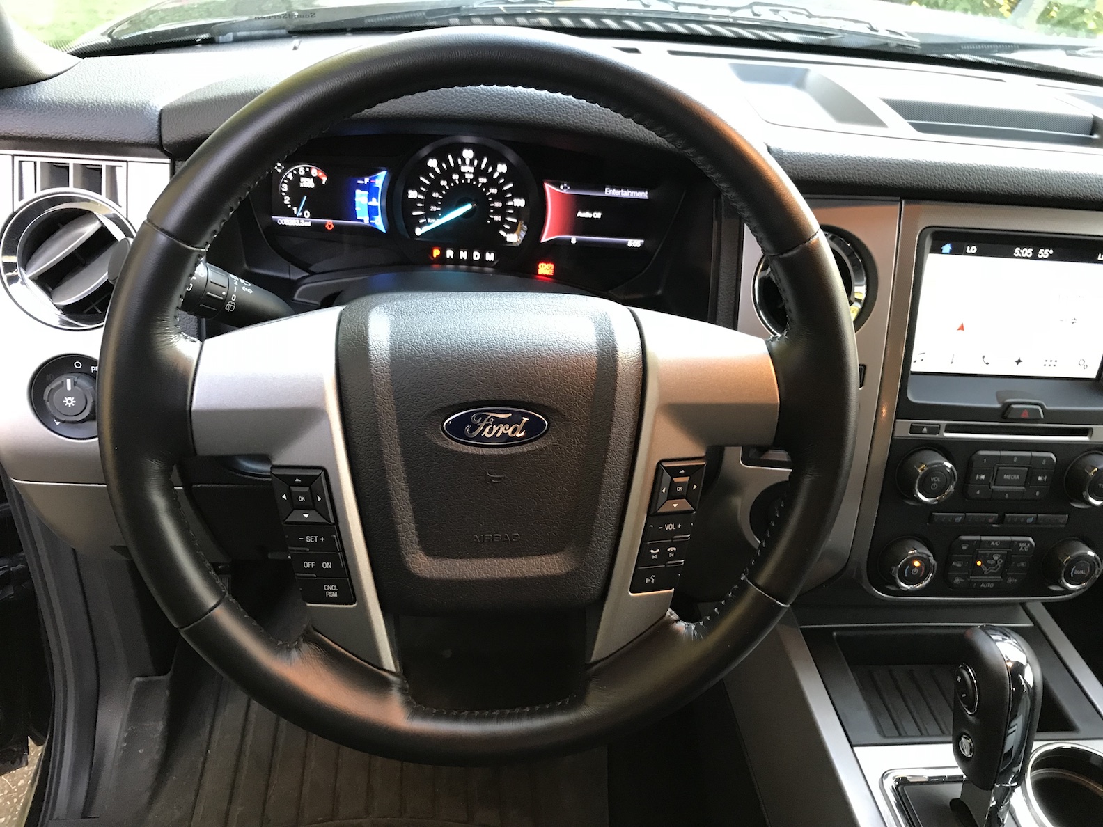

Thought I'd bump this up with some confirmations that nearly everything listed above works on my '15. I added the heated/cooled seat icons on the climate quadrant, six flashes on the lane change (I had to use C instead of A though), and activated Bambi mode. Due to needing to eliminate the DRLs for my retrofits, I also turned them off, and eliminated the DRL option from the IPC. The last change I've made so far has been to up the TPMS to 45 PSI because of my LT tires that I run at 50 normally.
Tried changing the boot screen, but it always boots up with the standard Ford one (SYNC 2). Same deal with ambient lighting color with door ajar. I haven't found the correct address in the APIM module yet.

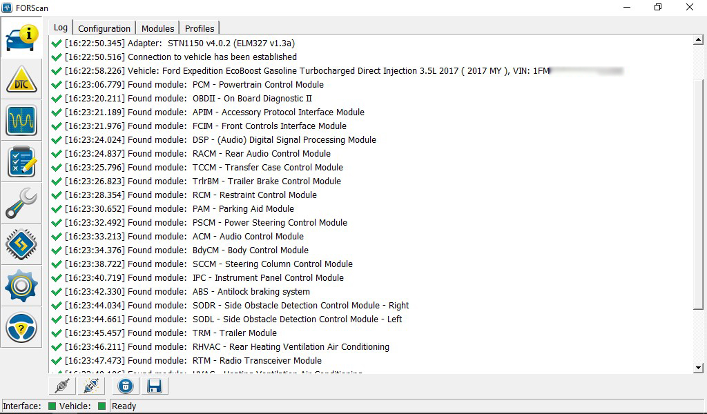

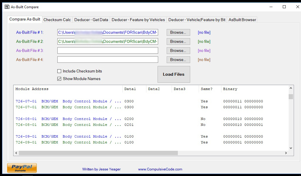

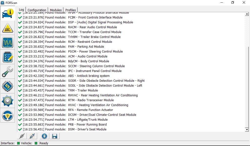

I've been experimenting with FORScan on my 2015 Expedition. The more I play with it the more I'm finding out that a number of codes do differ on the Expedition from the F150. For those wanting the double horn honk disabled (when you step out of the truck with the key with engine running), the code does differ from the F150. After some trial and error I found it. To disable it, locate 726-16-01 in the BdyCM. The line will look like: xxXx xx
If the capital "X" has a value of 1 the double horn honk is enabled. Change the capital "X" value to a 0 and it disables it. Ignore any of the lowercase "x" values. Hopefully this helps save some others time that want to disable this feature!
