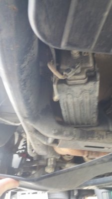

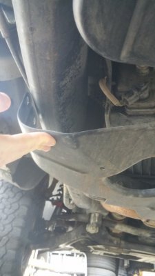

Fuel filter, are you in there??
Adieu
Dec 22, 2016
3,700
786
SoCal
...if so, how do I get you out?
And if not, where the hell are you????

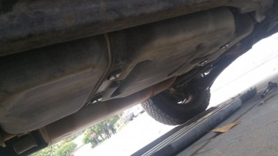

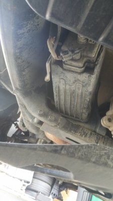

Not here either

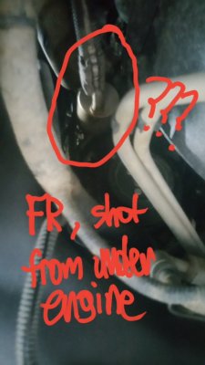

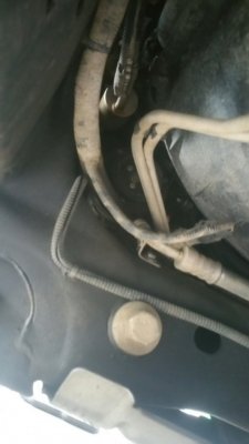

....but wait up, isnt this it????? However, why the hell is it UNDER THE ENGINE, by the front right coilover????

Yeah reading is grrrrreat, I know it **says** it would be there
....but in the SSV, it just ***ISN'T***.
Now there IS a fuel filtery looking thing underneath(ish) the engine block by the passenger side front wheel well.... but no fuel filters on any frame rails
