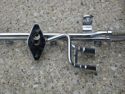

hi, i have a 1997 Expedition XLT 4x4 with the 4.6l V8 engine, the truck is going to be a offroad beater truck and i have a problem with a rotted fuel line (either the send or the return one)
my idea is to run a new fuel line from the fuel filter up to the fuel rail, and a return line from the fuel rail down to the tank, problem is i dont know where the ''in'' and the ''out'' is on the fuel rail, for example is the fuel regulator on the ''out''?
maybe that not that clear but i hope you understand!

the supply is usually the larger diameter one
you do realize you need to replace this with high pressure lines and the proper fittings
I would just buy the proper replacement lines and be done with it

thanks, make sense and normaly the fuel regulator is on the exit on the rail, just wasnt sure on these trucks/engine. ill be trying it this way.
