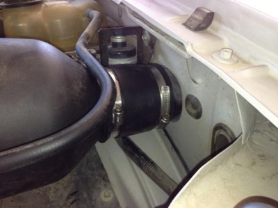

For those with the weird "add-on" to their factory airbox like my 04, this mod is even easier. Remove the extra leg (it unclips), get a short piece of black ABS, a 3" coupler from home depot.. No cutting of the factory parts, no gluing, just a bit of grinding to the abs to get it started in the hole.. Then a hammer and 2x4 are your friend.
BEFORE:
AFTER:
Took about 25 mins total, most of which "convincing" the ABS pipe to fit into the factory opening.

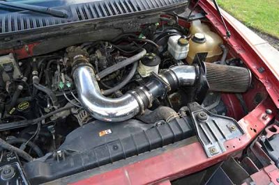

New here and new truck (to me). was wondering if there is anything wrong with what i did?
4" to 3" coupler and 3" ABS
Yes..., I don't believe that you have an air filter anymore? Unless it is over the intake?
