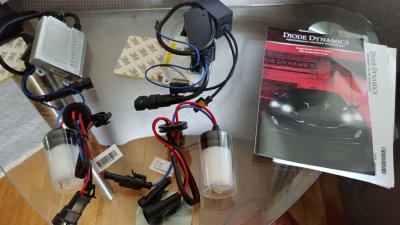

SL-1 install today. Roughly 20 minutes, easy as pie. Light looks great. Now to upgrade the H7 high beams to match the color!

Drove home last night. DRASTIC DIFFERENCE. Highly recommend!
Anyone have an H7 high beam bulb they like in a brighter white?
