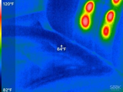

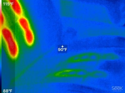

9131 is a picture of the working passenger seat, the other is the driver's seat with the non-functioning bottom. Ordered a used one and it doesn't heat or cool either.
Welcome to the forum. Did the seat that you bought specially have heating and cooling in it or was it a non heat and cooled seat?

I bought the TED to replace a non-functioning unit in the heated/cooled seat that came in the auto.
