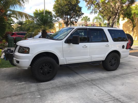

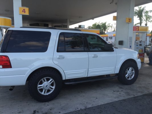

Yes sir, with the 3.5/2.5 lift 35s fit without any trimming. I have my front bumper trimmed to fit 35s before I installed lift and they fit just fine then too.
Before lift with 35s:
After:
waldo
Dec 21, 2010
80
25
Miami, FL
Btw that first picture is very appropriate, get used to being in a gas station [emoji23][emoji23]
