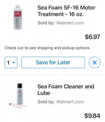

Use Sea Foam in gas tank and threw throttle body. Sold in store and online few bucks more in store.

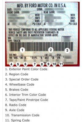

What gears does it have?
3.31 and 3.55 both should have no problems. On the rear diff metal tag it will show or call dealer give vin will tell you gearing.
Or check the door piller/door sticker will tell you.
