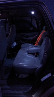

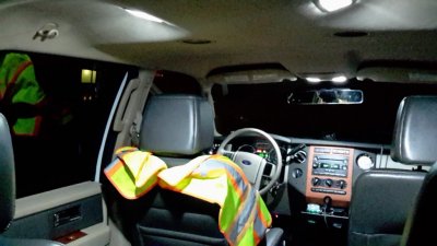

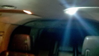

Got a led kit for my 99 EB Expy off of eBay. Unfortunately, it only came with the ones to do the front half of the interior, under the hood, the steps, and the license plate bulbs. the back seats and cargo are the bar type. still was only $12 after shipping for 20 led bulbs off eBay. You use to be able to get the bar types at most auto parts stores (can probably get them online cheaper). Sorry that I don't have before pictures, pretty disappointed I didn't get them because it is a huge difference! Install took about an hour. A pointer when doing the rear seats and cargo lights that I wish I would have had know before I started them. Take the clear plastic lenses off the front of the fixtures that you pull from the ceiling don't try taking the backs off. as for the overhead console, the bulbs twist out. One last thing if you have steps that you're doing and/or the license plate bulbs, MAKE SURE you use dialectic grease! they won't last through one day of driving in the rain otherwise.
