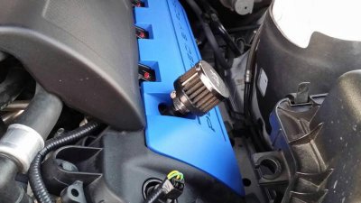

Very nice, thanks for sharing. Love how you painted the lettering on the engine cover too Very cool. Which ink pens from Amazon did you use?

Here is the link for the paint pens I used on my intake cover. https://www.amazon.com/gp/product/B000WXBEP0/ref=oh_aui_detailpage_o08_s00?ie=UTF8&psc=1
