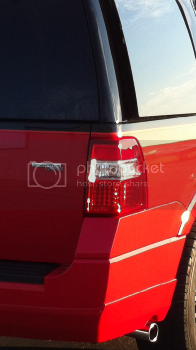

2008 as well. I added LED tail lamps (LED units, not replacement bulbs) several years ago and definitely needed to use resistors. Flash rate is correct, 100% in sync with side mirror signals. Not only does it look stock, it should have been.
I wasn't impressed with any of the LED replacement bulbs I bought a few years ago. I wanted as bright if not brighter than stock. Most of the LED bulbs I found weren't. And if they were, there was a disappointing intensity/output difference between parking light and stop/turn modes. Or, they were only brighter at certain angles. Accident waiting to happen if you ask me. Super Bright LED in St Louis seems most knowledgeable.
I'm happy with my rear LED lamps, believe they are Eagle Eye brand. Front are stock.
