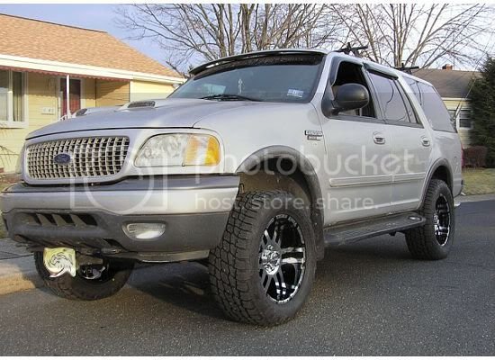

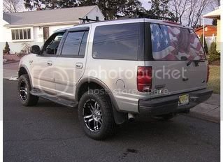

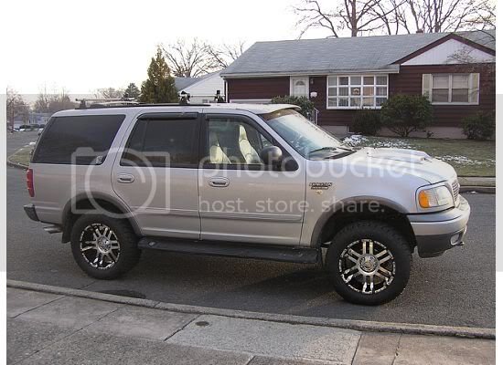

there are 2/3 level lifts availible or in your case 2/2 spring spacers, they will give you the clearance you need to run up to 33 inch tires so the 18/305s will work
