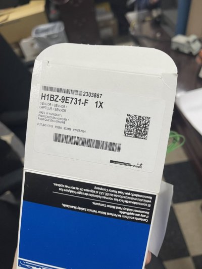

My car was hit while it was parked on Halloween night. The radar sensor was ripped out. the body shop ordered an new one and when the received the part, (Part number H1BZ-9E731-F) it came with 8 green wires. There are 4 wires hanging from my vehicle (black blue yellow and green). The have been unable to find the correct wiring diagram to install this park. Would you happen to have any suggestions as to how we can get this taken care of? We are 5 months in with out our vehicle and this is the last part that needs to be installed before we can get our vehicle back. I will attach a picture of the wires on my vehicle as well as the part that was sent.
Thank you.
