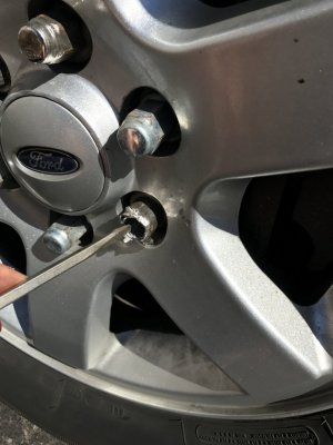

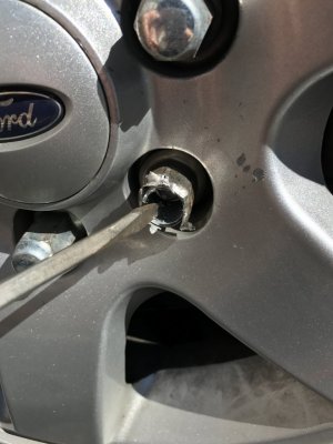

Best way is to take a sturdy flat head screwdriver I've found and bash it with a hammer out toward the edge then bang it inward and pry to rip the coating off.

Yeah the stock ones are cheesy,especially up here where we have a lot of road salt to rust the crap out of everything. They usually bubble under the cheesy chrome cap.snafu..

Currently replacing my lug nuts with solid ones. This is what you have to do to at least one just about every time you remove gen stock ones.
That IS insane, now I understand the previous comments about lug nuts. That is NUTS!
I gotta see if my nuts are like the on my 2014 and replace them if the case. I just had my tires rotated yesterday and I see dents in the top end so I think they are. How could lug nuts NOT be solid? I'm amazed. Plus just noticed the paint starting to bubble on my hood. Garbage.
NUTZ lawsuit ---> http://www.autonews.com/article/20170825/OEM01/170829821/ford-sued-over-inferior-design-of-lug-nuts
