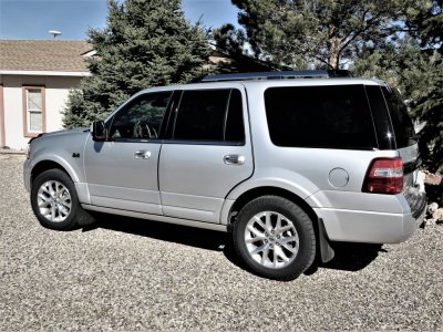

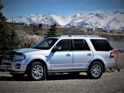

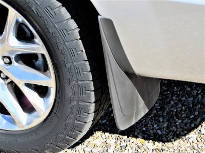

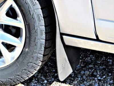

Since I drive off-road often, mud guards are very important, especially with the deployable side steps. I used standard molded mud guards in the rear and straight flaps in the front. I will post some photos sometime today, when the frost melts... Altogether cost of about $60 and some self-tapping screws.

I caulked it all off with a decent outdoor black window sealer silicone. The screws generally shouldn't penetrate metal, only the plastic of the outer wheel well molding and the thinner plastic of the wheel well. I used some old conveyor belt that I cut to fit as backing in the thinner wheel well plastic to add some strength. So no real need to worry about metal corrosion installing the mud guards. I sealed them so the backs don't get the water mud lines from leakage. Purely cosmetic and vain, but hey, she is new and beautiful now, wanna keep her looking good.
