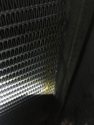

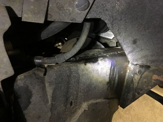

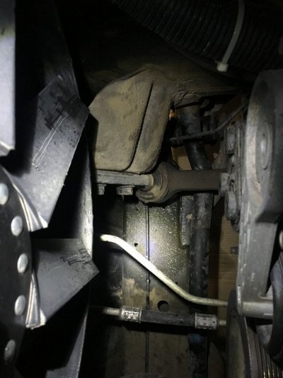

I changed out the radiator today. The radiator itself was a FoMoCo radiator- not sure if original or a replacement.
I had been smelling coolant for awhile but never found a leak. With the upper air diverter in place, I couldn't see the small leak on both sides where the fins meet the end tank.
I got the replacement at Advance Auto. It was listed as a "Car Quest" radiator but the box said Premier1. Made in China. Roughly $200 before using Speed Perks and a discount code that drove the price down to about $140. Seems like a good quality replacement. Also replaced the lower radiator hose. I watched a few videos on how difficult it is to remove so I figured it was smart to replace it while I was in there.
I also cleaned out the expansion bottle. There was some nasty sediment in there. There was also a bunch of sediment in the radiator.
After I was done, I took apart the old radiator and found the transmission cooler. I got to say, I'm not impressed.
Getting the 6.0L diesel cooler (which is about as wide as the radiator) seems like a smarter deal all the time.
